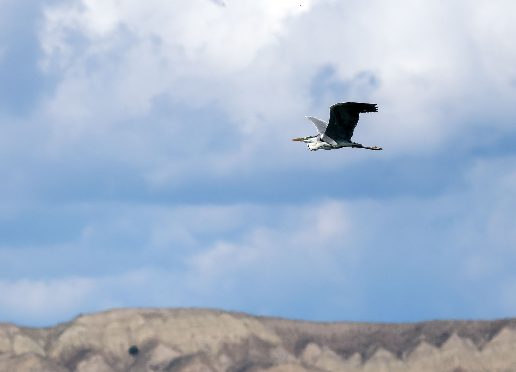

R7 + RF100-400mm F5.6-8 IS USM
Серый гусь
 Greylag goose by Natalia, on Flickr
