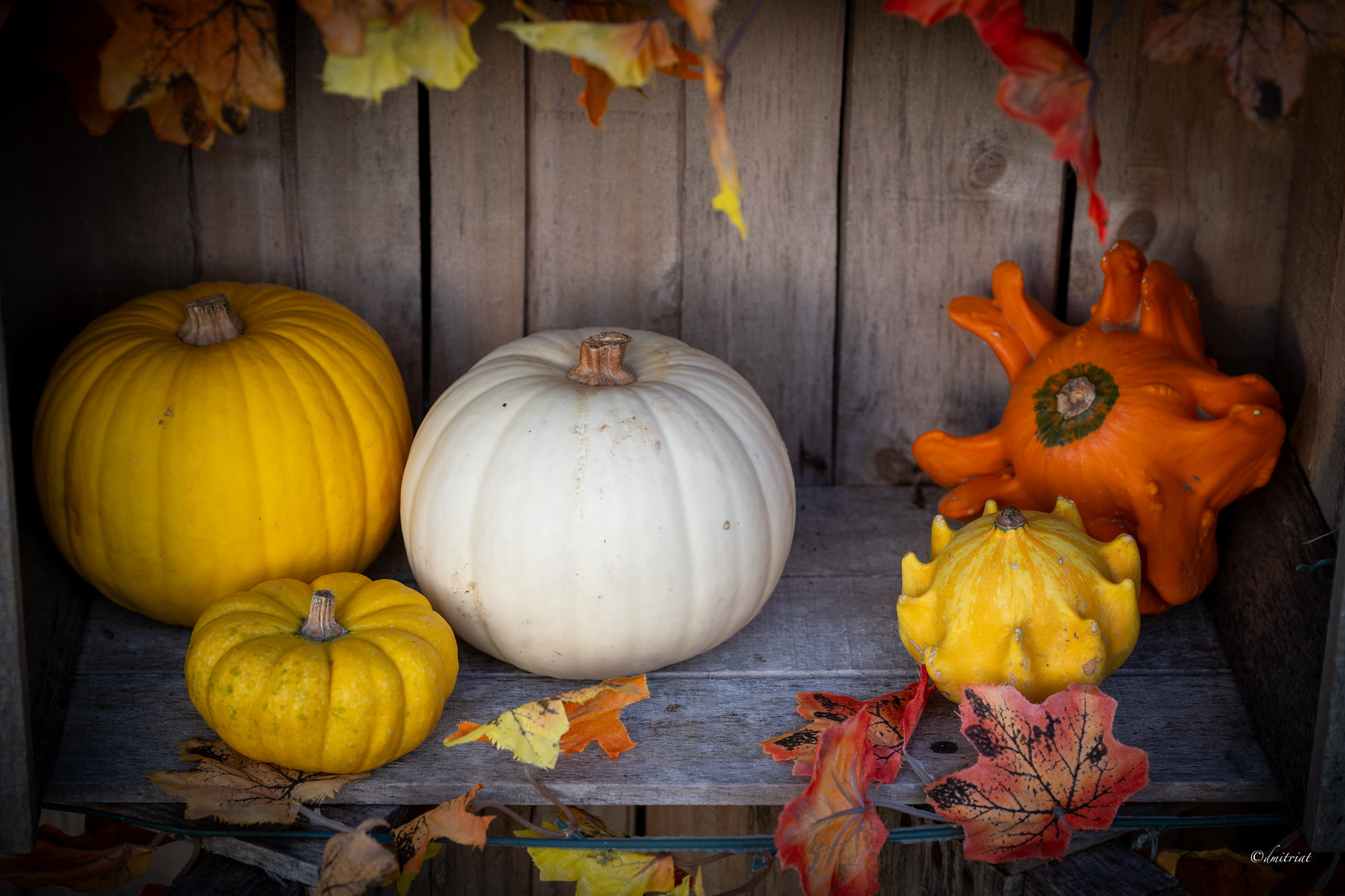

Z8, 24-120S
 DSC_8353 by dmitriat, on Flickr
 DSC_8349-2 by dmitriat, on Flickr
