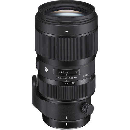

Sigma 50-100mm f/1.8 Art
Всего 380 сообщ. | Показаны 1 - 20
Sigma 50-100mm f/1.8 Art
Однако Сигма продолжает удивлять...
Another world first zoom is the 50-100mm f/1.8 DC HSM Art for DSLRs which provides shooters with an equivalent focal length of 75-150mm, or 80-160mm when used on Canon’s APS-C bodies. Wearing Sigma’s high-end Art title, the 50-100mm aims to deliver excellent optical performance that can rival prime lenses, meaning this one lens can replace three common prime focal lengths: 85mm, 100/105mm, and 135mm. Incorporating Art line innovations, the lens features three F Low Dispersion (FLD) and one Special Low Dispersion (SLD) element as well as one high-refractive index and high-dispersion glass element to keep aberration to an absolute minimum. All this combines nicely with the fast and constant f/1.8 for shallow depth-of-field effects with high resolution.
The 50-100mm lens also features a redesigned and improved Hyper Sonic Motor (HSM) that is 30% slimmer for fast and accurate movements. It also has a polycarbonate diaphragm made with fluorine and blades that feature carbon feather film for smooth and consistent operation. Another professional design element of the lens is the internal focusing and zoom operation, meaning the lens does not extend or retract during use, preventing intrusion of water and dust as well as ensuring proper balance. Additionally, it has a tripod foot for stability when using a support system and will be available in Canon EF, Nikon F, and Sigma SA mounts.
Re[Борис Коло]:
Performance
Focal Length 50 - 100mm
Comparable 35mm Focal Length: 75 - 150 mm
Aperture Maximum: f/1.8
Minimum: f/16
Camera Mount Type Nikon F
Format Compatibility Nikon DX
Angle of View 31.7° - 16.2°
Minimum Focus Distance 3.12' (95 cm)
Maximum Reproduction Ratio 1:6.7
Elements/Groups 21/15
Re[Борис Коло]:
ай да Сигма, ай да хлопнула Кенон с Никоном.....
Re[Борис Коло]:
Пролетное стекло дл я производителя.
Закос под универсальный портретник, но мало кто так серьезно снимает людей на кроп, чтобы покупать тяжелое дорогое кроп-стекло.
Проще и дешевле купить ФФ с оптикой.
Вот разве что на Фудж S5 кто-то поставит - это удобно.
Re[KOt]:
Гы.
Вот не уверен! В мире больше чем дофига людей, снимающих на кропо-кэнон и кропо-никон.
Теперь у них есть замечательный контраргумент против родных 70-200/2,8 (один из основных на ФФ)
Такой вот комплектик на кроп:
Sigma 18-35mm f/1.8 DC HSM Art
Sigma 50-100mm f/1.8 Art
Для самоуважения можно и 35/1,4 Арт докупить....
Что там ФФ может контр-предложить?
Re[Борис Коло]:
1400 баксов за кропо-стекло? :) Многовато....
Я уже не говорю про вес этого девайса.
18-35, кстати, более логично. Для пейзажа кроп ничем не уступает ФФ.
А вот представить себе серьезно снимающего людей с кропом - не могу. А если не настолько серьезно - то это стекло точно не купит.
Re[KOt]:
от: KOt
1400 баксов за кропо-стекло? :) .
1099 на БиХе.
Не так уж и дорого... Позволю себе напомнить цену родного Canon EF 70-200mm f/2.8L IS II USM - 1999
Re[Борис Коло]:
Да там альтернатив родному хватает. Кроме того, 50-100 и 70-200 - разные совсем.
Если на кроп кто и берет 70-200 - это спорт, звери...Сигма для этого явно не подойдет.
Re[KOt]:
от: KOt
Да там альтернатив родному хватает. Кроме того, 50-100 и 70-200 - разные совсем.
Если на кроп кто и берет 70-200 - это спорт, звери...Сигма для этого явно не подойдет.
Тогда альтернативой будет 50-135/2,8 (уже, похоже, снятый с производства)
Прошу прощения, но максимальная диафрагма тут КАРДИНАЛЬНО отличается!
... а какие же ещё есть "альтернативы"?
И, Олег, напомни, пожалуйста, - кто там говорил про "отличную резкость на открытых" у Сигм серии Арт? ;)
Re[Борис Коло]:
Да это все понятно. Технически Сигмы на уровне - ну, может кроме АФ.
Я просто плохо себе представляю "словесный портрет" покупателя.
Стоит пробежаться по кропо-веткам К и Н - там сотни владельцев.
Сколько из них серьезно снимают статичные портреты? Так, чтобы вместо стандартного полтоса купить это стекло?
Re[KOt]:
от:KOt
Да это все понятно. Технически Сигмы на уровне - ну, может кроме АФ.
Я просто плохо себе представляю "словесный портрет" покупателя.
Стоит пробежаться по кропо-веткам К и Н - там сотни владельцев.
Сколько из них серьезно снимают статичные портреты? Так, чтобы вместо стандартного полтоса купить это стекло?
... на Пентакс бы покупали.
Теперь, когда у НАС есть ФФ - не будут... даже в производстве К-маунт не предусмотрен!
Re[Борис Коло]:
Для меня это просто новость года. Всегда ждал хороший портретный светосильный обьектив на кроп- получил даже больше. Жду продаж
Re[Борис Коло]:
Сигма,конечно,задала темп,но как по мне на ФФ такая стекляха более интересная.
Re[Борис Коло]:
pardon za translit...
A pochemu napisanno chto eto CANON EF MOUNT ? upominaets je krop...
Re[Serguei Gutenberg]:
Потому что EF mount и встанет на ФФ. Другой вопрос, покроет ли, думаю Борис нам всем расскажет :D
Re[OlAf]:
от: OlAf
Потому что EF mount и встанет на ФФ. Другой вопрос, покроет ли, думаю Борис нам всем расскажет :D
Борис (на практике) не расскажет, но сильно сомневаюсь, что покроет даже на прикрытых диафрагмах.
А физически поставить можно, в отличие от родных EF-S
Re[KOt]:
от: KOt
Пролетное стекло дл я производителя.
Закос под универсальный портретник, но мало кто так серьезно снимает людей на кроп, чтобы покупать тяжелое дорогое кроп-стекло.
Спрос рождает предложение. За последнии 5 лет количество моделей и их чисто тех хар-ки кропнутых камер выросло в разы Полный кадр это отдельная ценовая ниша определяется высокой..( думаю никогда не подешевеет) ценой производства матриц т.е и самих камер в руках потребителя.. ну и эконм.кризисы вносят свою немалую лепту в конечную цену.))
Re[Борис Коло]:
Никому эта линза не будет нужна. В плане съемки портрета лучше взять ФФ и фикс дешевле (например 5d + сanon 85 f1.8 ), чем брать эту тяжелую и дорогую сигму на КРОП. Визуального прироста она никакого не даст по сравнению с ФФ, да к тому же тяжеленная!
Re[Борис Коло]:
Ура!!! Наконец таки появился достойный портретник для кропа!!! Молодцы Сигма, порадовали! Хотя могли бы и стабилизатор добавить!
Re[Dakota81]:
del
