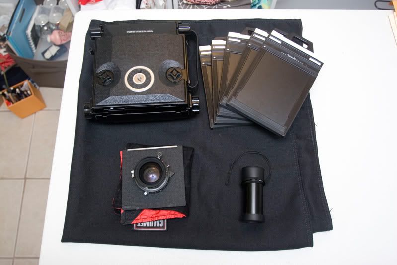

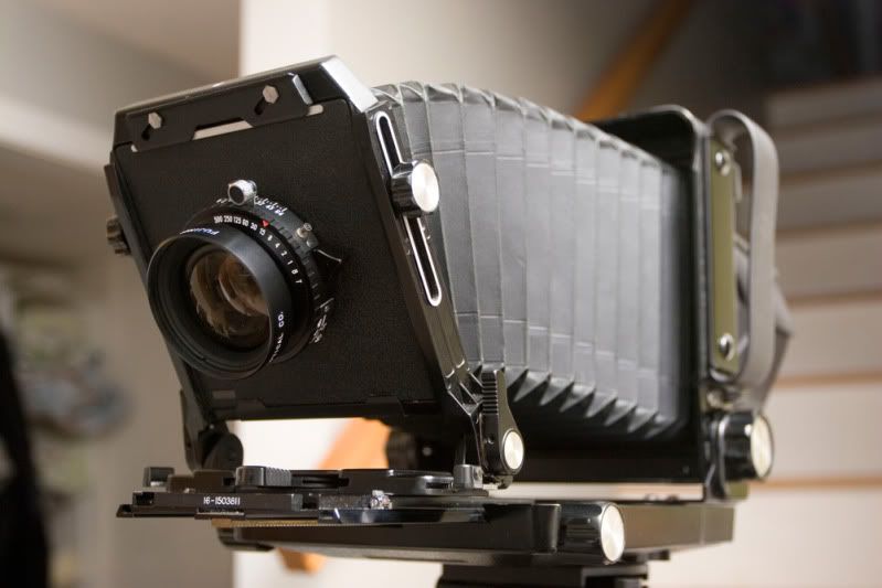

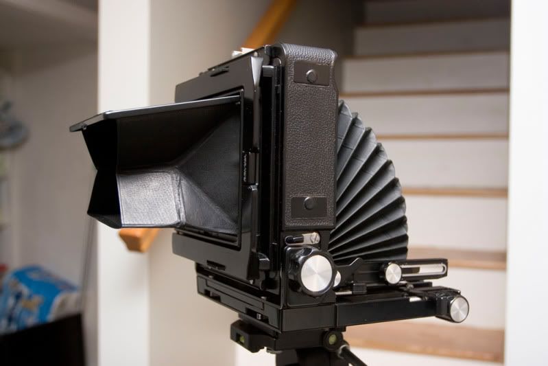

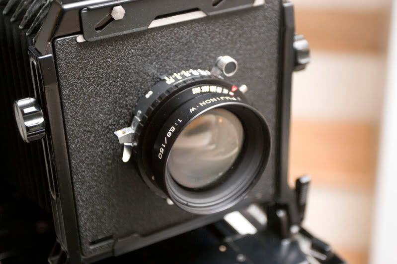

Тогда так:
[quot]I'm selling a 4x5 kit, I don't use it all too often and quite frankly - it's just getting a bit too pricey for me. It's a great kit, regardless.
It includes:
Toyo 45A with folding hood / bellows are light-tight, no cracks or dings, ground glass is perfectly fine, all movements work properly
Fujinon 150mm f/5.6 on Toyo lensboard / no scratches, no dust, shutter works perfectly
Toyo Loupe / no scratches or dust inside
5 Riteway holders / no light leaks, no cracks, work perfectly
Calumet lens wrap / no tears or rips
Calumet dark cloth / no tears or rips in this either
Calumet changing tent / no light leaks, comes with zippered case (not picture but will be included)
I'm not including a cable release, you'll have to get one of those yourself to complete this.
No bag included.
Tripod head not included.
Serious inquiries only, paypal preferred.
I would like $1000.00 for this, not really looking to break it up. Please feel free to email me at info.luong@gmail.com
